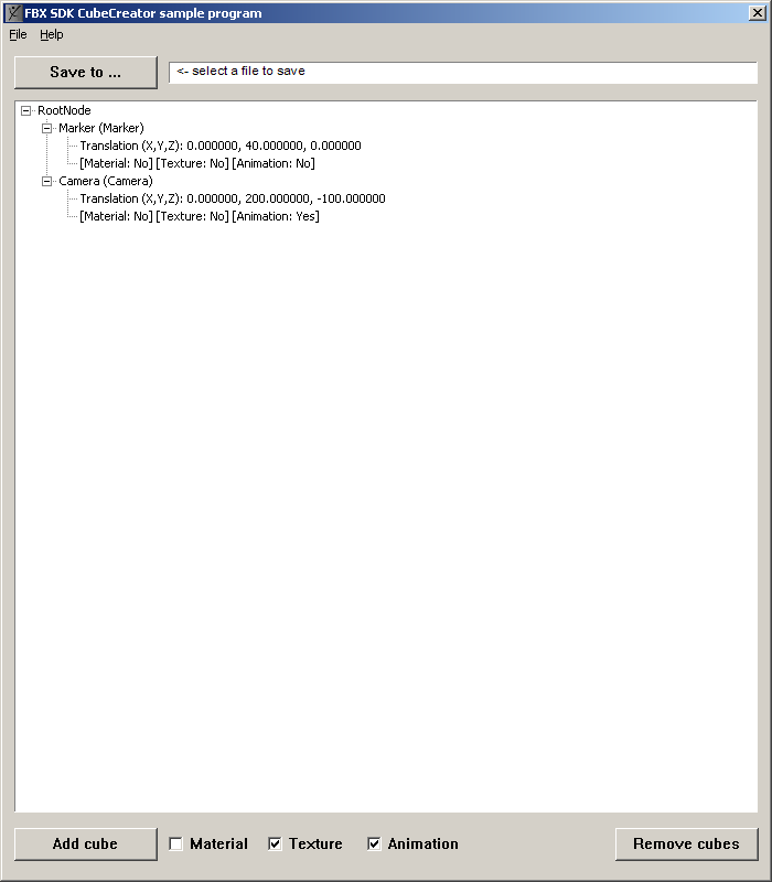

User Interface
The CubeCreator sample program shows you how to add textures, materials, and animation
to models in a scene.

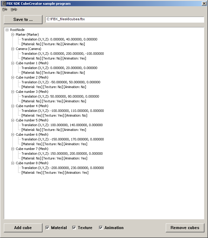

At startup, CubeCreator displays a tree view of a scene containing only a marker and
a camera.
As a user, you can add cubes one at a time to the scene. For each cube, you can opt
to:
- Add a texture.
- Add materials.
- Add an animation.
You can save the scene as an FBX file (or in any file format exported by FBX SDK).

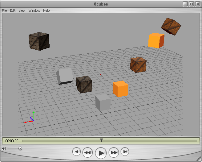

Here is what 8cubes.fbx (the scene shown as a tree, above) looks like when opened in FBX for QuickTime:

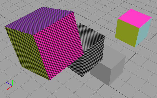

If FBX for QuickTime cannot find a texture file for a surface, it renders the surface
as a checkerboard pattern. Here is how that looks for the faces of our cubes:

- Invites you to use FBX for QuickTime to view and interact with the scene stored in
the saved file.
