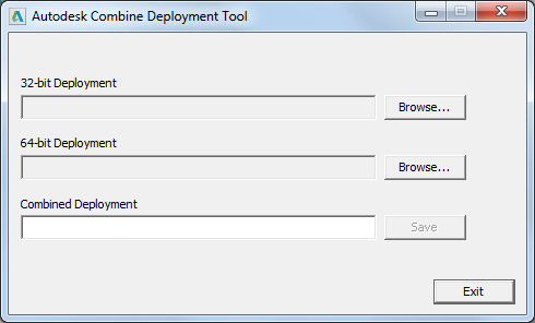

  2. In the deployment Tools folder, double-click the CombineDeploy.exe tool.
  3. In the tool panel, browse to the 32- and 64-bit deployments, and then enter a descriptive name for the combined deployment.
    The combined deployment is saved in the same folder as the 32- and 64-bit deployments.
