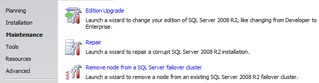

  1. Launch Setup from the Full SQL 2008 installation media. Select the Maintenance option, and begin the Edition Upgrade wizard.

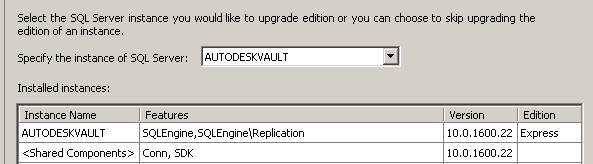

  2. Verify version and or product key for Full SQL 2008. Proceed to the Select Instance window and choose the AutodeskVault instance.
  3. Upgrade the Instance. Once the instance has been upgraded, you can install the SQL Management Studio by returning to the "Installation" option and being the New SQL Server stand-alone installation or add features to an existing installation wizard.
