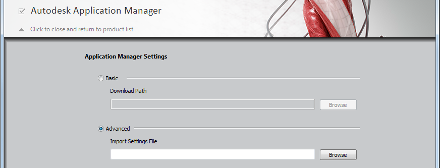

    Application Manager Configuration Panel
  4. In the Application Manager configuration panel, click Advanced and browse to the location of the settings .INI file. This file is added to the deployment image.
