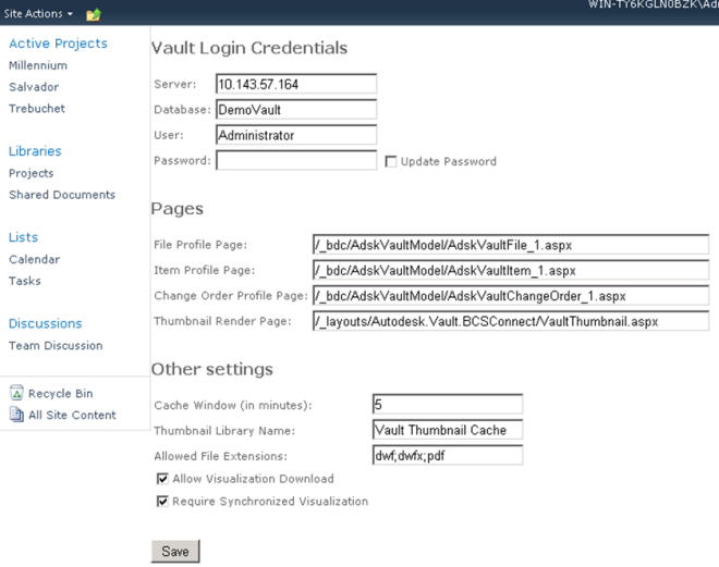

The first configuration page, Vault Settings, applies to the farm. This page should be configured by a site collection administrator. The default location for the Vault Settings configuration page is:
_layouts/Autodesk.Vault.BCSConnect/VaultSettings.aspx

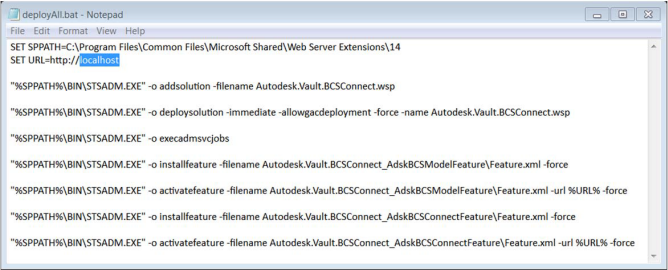

The deployAll.bat file deploys the Vault integration to the default collection. When using the deployAll.bat file, deployFarm.bat and deploySite.bat are not necessary. Each of the deploy batch files has an equivalent retract batch file for removing the solution. The deployAll.bat file can be used when the default site collection is the only collection or when there are multiple site collections.
The deployFarm.bat file deploys the SharePoint solution, the BCS model, and creates the Vault Settings web page at the farm. deploySite.bat supports deployment of the three default lists to a specific site collection. You must modify a path within each batch file to use the deploySite.bat file. Instructions for modifying the path are detailed in the next section.

Set URL=http://ServerABC
Server name = ServerABC
Site Collection = Engineering
Set URL=http://ServerABC/Sites/Engineering

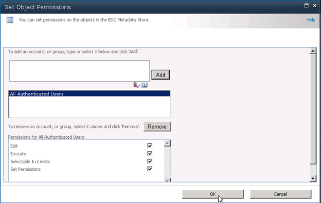

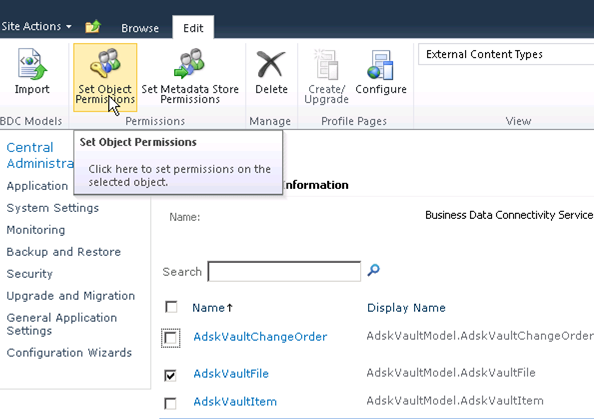

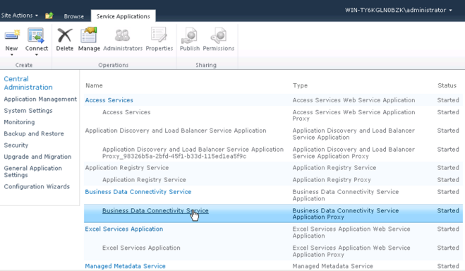

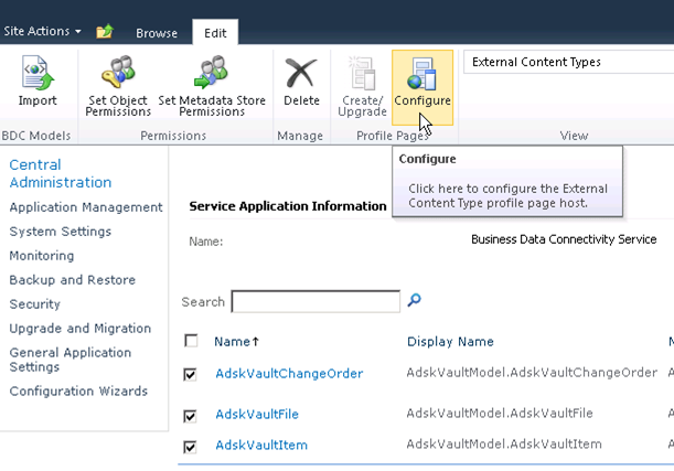

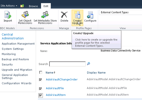

You must configure access permissions for Vault files. If you are using Vault Professional, you will also need to configure access permissions for Change Orders and Items.
You must configure the profile page to recognize Vault Files. If you are using Autodesk Vault Professional, you will also need to make change orders and items recognizable.
After configuring the Profile Page, you must create and configure your Vault Login. One Vault Login will be used by everyone accessing the vault, so a custom Vault user should be created.
This user requires read access to the objects that you want Vault to see in SharePoint.

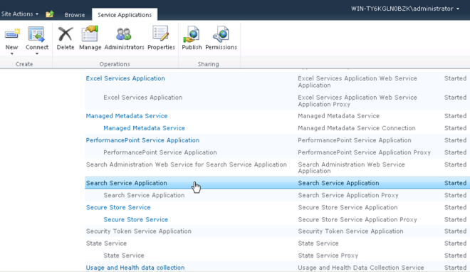

Once you have set up the Profile Page and created the Vault login, you must configure Sharepoint to allow Vault searching.

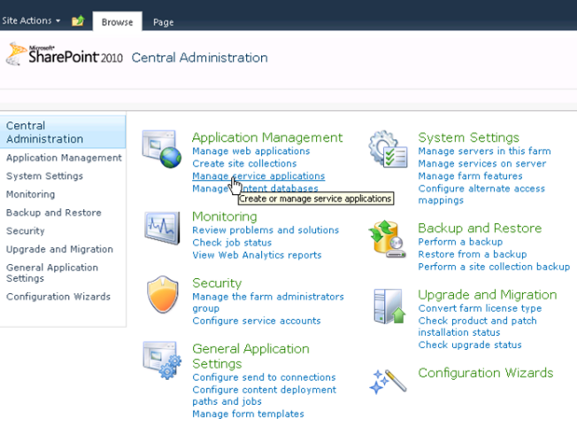

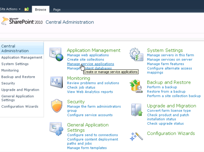

From Central Administration click Manage service applications under Application Management.
Click Search Service Application.

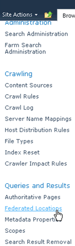

Under Queries and Results on the left hand side, click Federated Locations.

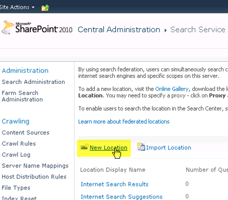

Click New Location.
