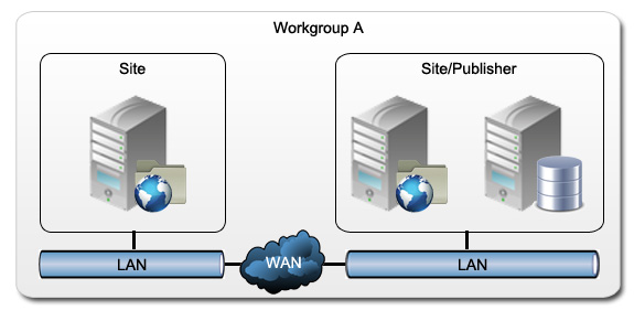

Example Scenario
This pictures shows one Workgroup for simplification purposes. However it could be possible to already have multiple Workgroups configured.
Current State: Workgroup A consists of a Publisher and two sites.
End State: Two Workgroups, Workgroup A is the Publisher, Workgroup B is a Subscriber
