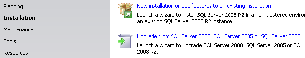

  1. Launch Setup from the SQL Express 2008 R2 installation media. Select the Installation option, and begin the Upgrade wizard.

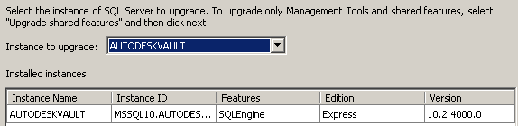

  2. Select the AutodeskVault SQL instance.
  3. Upgrade the instance by completing the wizard.
