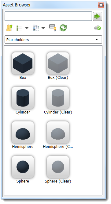

Solid and transparent boxes, cylinders, spheres, and hemispheres are installed with Factory Design Suite and stored in the Placeholders system assets folder.
To add a placeholder asset to your layout:
  1. Click Palettes in the Factory ribbon.
  2. Select Asset Browser.
  3. Locate and open the Placeholders folder in the System Assets folder.
  4. Select a placeholder shape (either solid or clear) and drag it onto your layout. As with other assets, you can explore, preview, copy, or add a placeholder asset to your Favorites folder.
