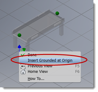

Complete the following steps to automatically place and ground the component at the layout origin (0, 0, 0). If the model has a defined insertion point, the insertion point aligns to the layout origin.
  1. Click Factory tab Factory Components panel Insert Model .
    If you are working with Autodesk Vault, then click Factory tab Factory Components panel Insert Model from Vault .
    Note: This option is only available when the Vault client is installed.
  2. In the Insert Model dialog box, browse to the folder location, select the file to insert into the layout, and select Open. The model appears and follows the cursor movement.
  3. Press the right mouse button and select Insert Grounded at Origin.
  4. Right-click again and select Done to end the insert command.
