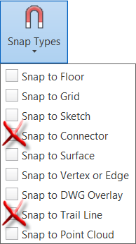

Accurate linear positioning of a factory component along the X, Y, or Z axes can also be obtained using a snap type. All vertex types (point, sketch point, point cloud point, vertex, etc.) are selectable using this method.
Restriction: Only perpendicular edges/faces to the current reposition axis may be snapped to. Also, the Snap to Connector and Snap to Trail Line snap types are not supported.

  5. Hover your mouse over an allowed snap candidate and a preview of the move is displayed. The various snap types are enabled/disabled from the Snap Types drop-down menu on the toolbar.

  1. Begin by enabling the Snap to Vertex or Edge and Snap to Trail Line snap-to options from the Snap Types drop-down menu on the Options panel. Disable the other snap-to options in the menu.
