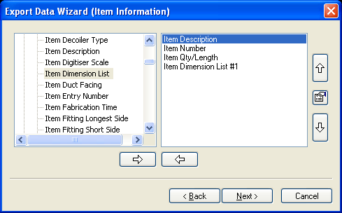

  5. In the left column, select the item data fields you wish to report. Move them to the column on the right using the right arrow button.
  6. The data field order can be changed by highlighting the field and using the up and down arrows to change the order.

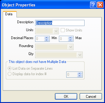

  7. To change the item data field description, you can select the data field, and click the Properties button , as shown below:
