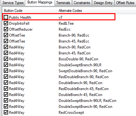

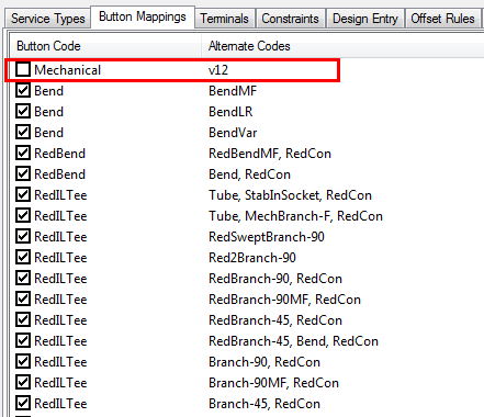

    Below are examples of button mappings of mechanical and drainage systems.
    Mechanical System Button Mappings Drainage System Button Mappings
