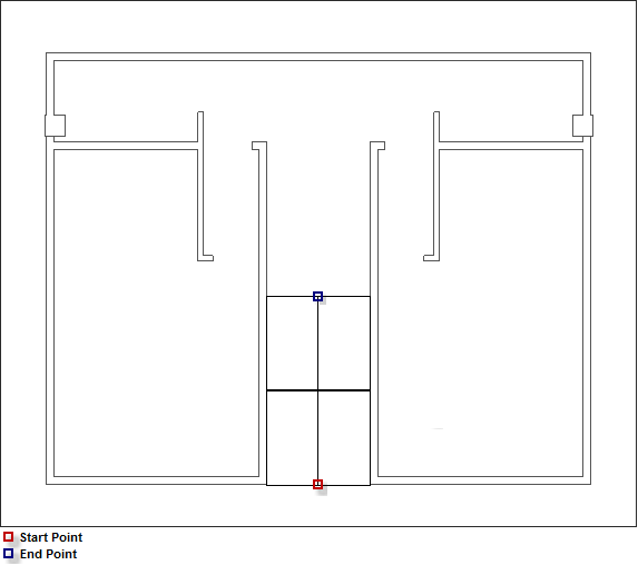

- In the model, click a start and end point to draw the multi-service line, but do not right click, to end the command.

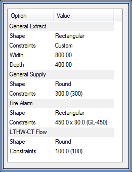

- Move the cursor to the multi-service line Options / Value dialog previously configured.
- Amend the service by selecting the appropriate field, then edit as required.

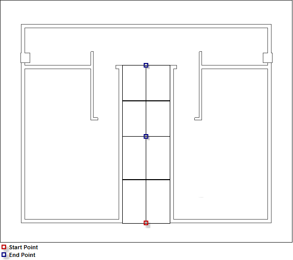

- Proceed with coordinating the multi-service line.
- To end the command, select an end point, then right click to end the command.

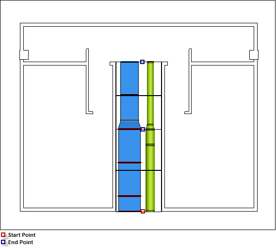

- Select within the click View menu Fill
, the items for each individual service will be applied to the multi service line.
