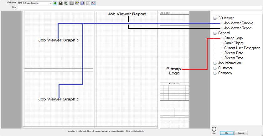

Customising Data Fields
The following diagram illustrates a Paper Worksheet including pre-configured data fields applied within each window.
To customise appropriate data fields within a specific window:

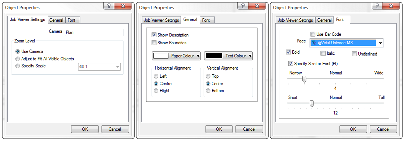

  1. In the 3D Viewer Worksheet Builder, right click on the appropriate Data Field within the Worksheet Builder window, and select Properties.
    The Object Properties dialog displays.
  2. Configure the options on the Job Viewer Settings tab.
    • Camera: Enables users to assign an elevation to the specific window within the model, for example: Plan, Bottom, Side, End, Isometric. Cameras applied within a model must be consistent with the Camera name settings within the Job Viewer Graphic Settings.
    • Zoom Level: Enables users to apply a various pre-configured Zoom and Scales for each Window were the Job Viewer Graphic has been applied.
    • Use Line Weights: When this option is selected, line weights are used in the Worksheet.
  3. Click the General tab, and configure those options as needed.
    • Show Description: Enables a user to either Turn "On" or "Off" the Description.
    • Show Boundaries: Enables a user to either Turn "On" or "Off" the Boundaries.
    • Paper Color: Enables a user to configure the Paper Worksheet Color.
    • Test Color: Enables a user to configure the Text Color.
    • Horizontal Alignment: Enables a user to align the Data object in the Horizontal Axis.
    • Vertical Alignment: Enables a user to align the Data object in the Vertical Axis.
  4. Click the Font tab, and configure those options as needed.
    • Face: Enables users to configure the Font style.
    • Bold: Enables users to enable or disable the Bold style.
    • Italic: Enables users to enable or disable the Italic style.
    • Underline: Enables users to enable or disable the Underline style.
    • Specify Size For: Enables users to enable or disable this option Font (Pt).

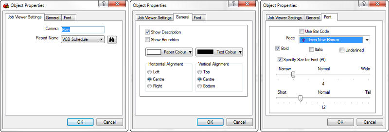

  5. To configure a Job Viewer Report , configure the options on the Job Viewer Settings tab.
    • Camera: Enables users to assign an elevation to the specific window within the model for example (Plan, Bottom, Side, End, Isometric). Note Cameras applied within a model must be consistent with the Camera name settings within the Job Viewer Graphic Settings.
    • Report Name: Enables users to apply a report schedule on to the Paper Space Worksheet Window.
  6. Configure the options on the General tab.
  7. Configure the options on the Font tab.

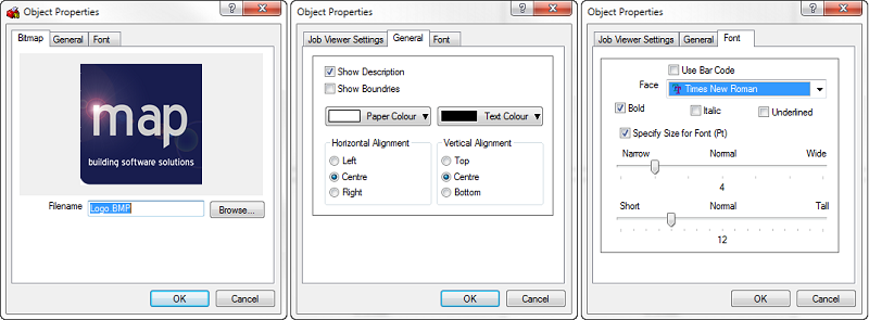

  8. To add a customised image (.bmp or .png) to the Paper Worksheet Window, right-click in the Bitmao Logo area and select properties.
  9. On the Bitmap tab, click the Browse button and navigate to and select the desired .bmp or .png file to import.
  10. Click the General tab and configure appropriate options.
  11. Click the Font tab and configure appropriate options.
