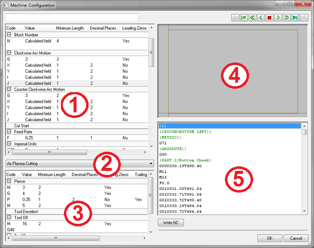

- Click Configuration to display the Machine Configuration dialog.
The Machine Configuration dialog lets you create or edit the controls codes (NC codes) for controlling general machine behaviors, as well as tool-specific behaviors, on a specified installed machine. For example, this dialog lets you create\write NC code for controlling general machine behaviors, such as motion, feed rate, arc centerlines, kerf, and more. This dialog also lets you configure tool-specific behaviors for the tool types that are included on the selected machine.

This area on the dialog |
Description |
1 |
The top left pane of this dialog contains settings that let you specify the NC code for controlling general machine behaviors, such as: - Arc Centers: Absolute, Relative
- Motion: Absolute, Relative, Arc, Linear, Clockwise, Counter Clockwise
- Feed Rate
- Units
- Kerf
- Offset Origin
- Program Start\End
- Rapid Traverse
- Subroutines
- Block Numbers
- Cut Start
- Part Start
- Remarks
2 |
Click this tool selection drop-down list to display and select each of the tools that are included with this machine. Only the tools that have been added to the selected machine are displayed in this list. To add tools to the selected machine, see Add Tools to a Machine. |
3 |
The bottom left pane of this dialog contains settings that let you specify NC code for the following tool-specific behaviors for each of the tool types that are included on the currently selected machine:
Pierce
Tool Deselect
Tool Off
Tool On
Tool Select
4 |
The top right pane of this dialog displays an NC view of the nested sheets for the current job. The buttons located along the top of this pane provide a variety of options for stepping through the machine motion. For example, you can Go To Previous Sheet/Next Sheet, Start\End, Backwards, Forwards.
The buttons located along the top of this pane provide a variety of options for stepping through the machine motion. For example, you can Go To Start\End, Backwards, Forwards.
5 |
Click the button to write or update the NC code specified. The code or updated code is displayed in this bottom right pane when this button is clicked.

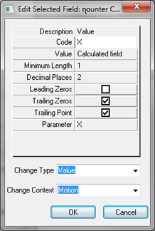

- Edit: Edit an existing behavior by double-clicking it, or right-click
Edit, to display the Edit Selected Field: Value dialog.
This dialog lets you edit the following parameters: - Code: Specifies the code.
- Value: Specifies the value.
- Minimum Length: Specifies the minimum length.
- Decimal Places: Specifies the number of decimal places.
- Leading Zeroes: Specifies whether or not to include leading zeroes.
- Trailing Zeros: Specifies whether or not to include trailing zeroes.
- Trailing Point: Specifies whether or not to include a trailing point.
- Parameter: Specifies the parameter.
- Change Type: Specifies whether the data associated with the type is a floating point value, integer, text or none.
- Change Context : Specifies which group of the internally calculated data can be used; for example, General (the machine setup parameter values in Globals, Details and Conditions), Sheet Properties, Motion, Cut, Parts, or Subroutines.
- Add: Add a new line of code by right-clicking
Add.
- Delete: Delete any lines of code that are not needed.
- Move Up\Down: Move the selected line of code up or down.
- Change Group: Allows you to change the group.
- Click OK to save any changes made using the Edit Selected Field dialog.
