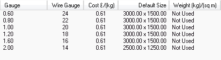

  4. At the prompt asking if this new material is to be based on the currently displayed material, click Yes to save typing in all of the thickness and sheet sizes, and copy the gauges and default sizes from the currently displayed material into the new material.
