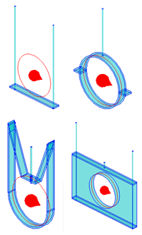

838 | Hanger | This pattern is used for a hanger. | ![]() |
