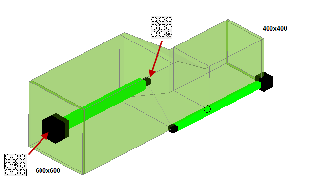

Auto Update Line Position: When Auto Update Line Position is enabled, using the Fix By setting will automatically draw a small line to the Fix By position automatically. You can just specify the new Fix By position and let the software dictate the line position location. The example below shows a center line movement to Flat Bottom.
Using the Automatic Method
The following example shows a center line movement to Flat Bottom.
  1. Start in 600x600 duct and move to the position where the offset is required.
  2. Selecting the new Fix By position when the is enabled shifts the Design Line to the new position.
  3. Type in the reducing size, and then continue to draw in the new Fix By position (Flat Bottom Right).

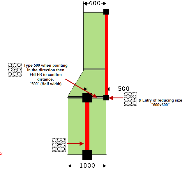

Using the Manual Method
The example below shows a 1000x1000 rectangular duct tapering to 600x600 keeping the right side of the duct "Flat Right". At the time of changing the Fix By position, you can point the Design Line in the required direction, and then type half the width (500) in Line Create mode. Press Enter to confirm the length required, then at the required Flat Right position, select the Fix By from Central to Right, as shown in the diagram below. Together with the reduction in size, using the dimension fields will allow you to draw the line Flat Right. Once Filled in 3D, the alignment should show that the duct is straight on the right side.
