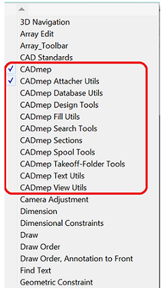

To display and or dock one of the flyout toolbars individually:
  1. Right-click on a toolbar button to display the AutoCAD Toolbars list. The Fabrication CADmep toolbars are listed here, preceded by CADmep, as shown below.
  2. Click on the name of the flyout toolbar that you want to display individually.
    For example, click CADmep Attacher Utils. When you do this, that toolbar is individually displayed on your screen, separate from the CADmep main toolbar. The CADmep Attacher Utilities flyout toolbar is shown below.
