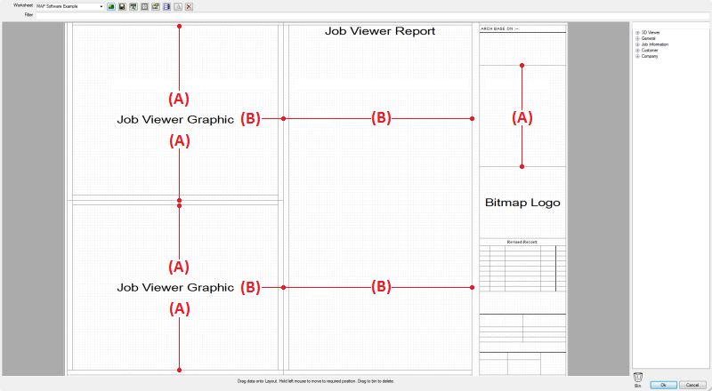

  1. Refer to the below diagram illustrating an example paper worksheet pre-configured split.
  2. Splitting Horizontal Windows:
    • As indicated as (A) on the previous illustration.
    • Right Click the mouse, A dialog menu is displayed , Select "Split Horizontal".
    • The paper worksheet will split in a Horizontal Window, as illustrated previously.
  3. Splitting Horizontal Windows:
    • As indicated as (B) on the previous illustration.
    • Right Click the mouse, A dialog menu is displayed , Select "Split Vertical".
  4. Deleting Horizontal & Vertical Windows within a Paper worksheet
    • As shown on the previous illustration
    • Right Click, within the appropriate window for deletion, A dialog menu is displayed .
    • Select "Delete" the selected window will be removed from the Paper Worksheet.
