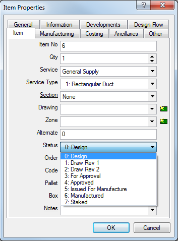

The Item Statuses dialog allows for the different stages of a model or job to be identified by its Item Status property. For example, an Item Status set to "Design" means that the drawing is still under construction. An Item Status of "Approved" could mean that the model has passes all checks and is ready to be sent on to production.

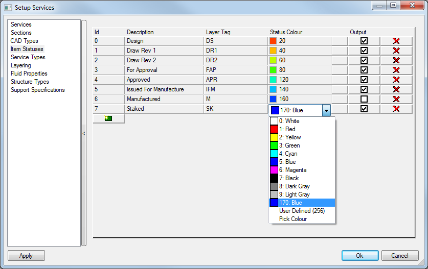

In the Autodesk Fabrication products, you can setup Item Status descriptions, Layer Tags, and color to suit your needs. You can also configure an Item Status to be included or not included in CAM (*.MAJ file) output.
To edit item statuses in the Database dialog:
to display the Edit Services Database dialog.
To add a new item status:
in the ID column.
To remove an Item Status from the database:
The Output option on the Item Statuses Database dialog allows the various Item Statuses to be marked as valid for output to CAM.

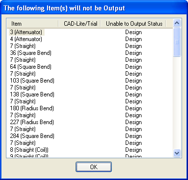

Any Item Status that does not have the Output option checked (enabled) will display the following dialog when creating the CAM output file:
This dialog indicates that the items listed will not be output (included) in the resulting .MAJ file.

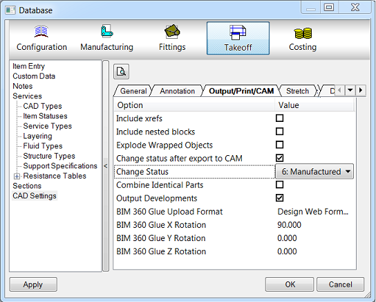

To add a status to an item:
The steps below describe how to automatically change an item's status when exported to CAM.
Takeoff
CAD Settings).
When you select this option, the Change Status option becomes active (editable).
This option can be useful when sending sections of a completed model for manufacture. If the Status is changed from "Design" to "Manufactured" and the Item Statuses - Output for Manufacture is unchecked, it would not be possible to output duplicate items for those items who's status is now "Manufactured".
