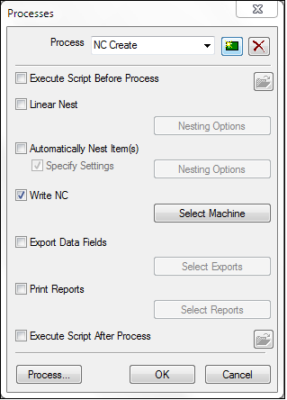

Setup, or click Setup Processes from the Utility Bar. The Processes dialog displays.
- Click New
. When you do this, a new untitled process is created.
- Rename the process from "Untitled" to something relevant for your process.
- Select and specify the desired options on the Processes dialog.
The following options are available:
- Execute Script Before Process: Clicking this option enables the Browse button which lets you select a script file. The script file specified here will be run before the rest of the process executes.
- Linear Nest: Click this button to enable the Nesting Options button.
- Nesting Options: Clicking this button when Linear Nest is selected displays the Linear Nesting Options dialog which lets you specify a Session ID.
- Automatically Nest Item(s): Clicking this button enables the Specify Settings option.
- Specify Settings: When this option is selected, you can configure a variety of automatic nesting options. When this option is not enabled, the default automatic nesting options are used.
- Nesting Options: Clicking this button when Automatically Nest Item(s) is selected displays the Automatic Nesting Options dialog which lets you specify a variety of options for configuring automatic nesting behaviors.

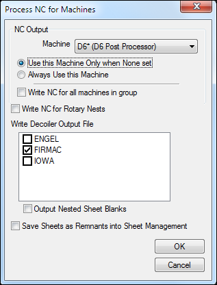

- Write NC: Click to enable the Select Machine button for configuring NC output for a specific machine.
Select Machine: Clicking this button displays the Process NC for Machines dialog which lets you specify a machine for NC output, as well as a variety of options for the NC output. On this dialog, you can select multiple machines from the list of installed machines available in the Machine drop-down list, and configure appropriate NC output options for each machine. This information can be stored in the same database.
- Export Data Fields: Click this button to enable the Select Export button.
- Select Exports: Clicking this button lets you specify the type of data to export for this process.

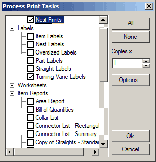

- Print Reports: Clicking this button enables the Select Reports button.
- Select Reports: Click this button to select the reports that will always be printed, and the number of copies that are required when using this process. Note that each report can have a different numbers of copies. Click OK when all report options have been specified.
- Execute Script After Process: Clicking this option enables the Browse button which lets you select a script file. The script file specified here will be run after the process specified above executes.
- Process: Clicking this button initiates or runs (launches) the process that is currently selected on this dialog.
- When you have finished specifying the options on the Processes dialog, click OK. The next step is to use (run) the process.

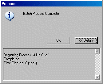

The actions set up within the process will now be performed, and a corresponded status dialog displays indicating that the process has completed.
