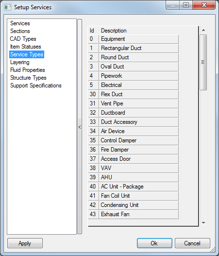

The Service Database includes six default Service Types. All Product Lists items and Fitting Templates have been assigned to the relevant Service Type and in most cases there will be no need to add to the list. If it is necessary to create a New Service Type follow Step 1.
The Service Type is used to categorise CADmep products and define the layering tag system when drawing.
To attain the required layering system, new Service Types can be added and associated with specific product lists. e.g. Pipework product lists (Victaulic, Welded, Plastic, etc), have the Pipework Service Type assigned, but to assign all the Drainage Pipework to a different Service Type follow the procedure below.
Id number - N/A
Description - This is the name given to the New Service Type added.
