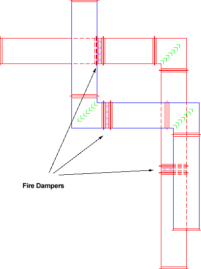

  1. Open a drawing that contains a variety of CADmep (Fabrication) items, or draw some items from scratch.
    The sample drawing below shows two sets of items on separate services. Each service run contains fire dampers that need to be edited. To select these dampers might be difficult, even on a drawing as simple as this. For this reason, the Search / Filter for Objects command can be used to isolate the dampers from the rest of the drawing.

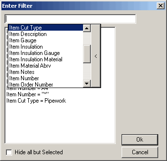

  1. Click in the field located at the top of this dialog.
    When you do this, a drop-down menu displays, showing all the objects that can be used for the filter.
    The list of items shown here is determined by what the selected objects have in common. If all the items had a similar name, the Item Description Object could be selected. If the items were based on a similar template, the Item Custom ID Number (CID) could be used. For this example, all the Fire Damper items are made from the same template and also had the same name. For this reason, the Item Custom ID Number (CID) will be used.

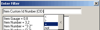

  2. From the drop-down list, select Item Custom ID Number (CID).
    Once you make a selection, a second drop-down menu displays, showing a list of operators.
  3. Select the equal symbol (=).

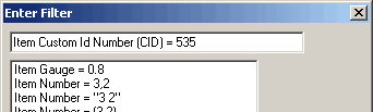

  4. Click after the = symbol, and type in 535, as shown above.
    535 is the CID number of the Fire Damper Item. The CID Number of any item can be ascertained by using the Change Object Properties command. The CID Number is commonly found under the General tab.

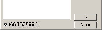

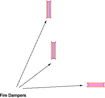

  5. Check the Hide All but Selected option.
    The drawing should now only display the Fire Dampers.
  6. To show the rest of the drawing, use the SHOWALL command.
