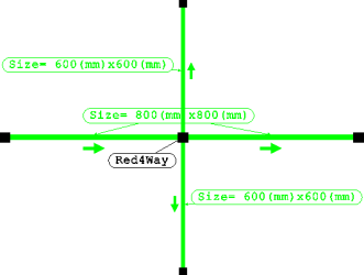

For example, a Red4Way Node Keyword could transpire in a mapping to a Straight and 2 Shoes or just use a Cross pattern that accommodates the Node keyword using its Button code. The Cross would be used if the branches are equal. If the branches were reducing, that could mean the Cross pattern is unable to reduce and therefore move to the next available scenario being the two Shoes from the Service Button Mapping tab. With this logic we can determine scenarios and exclude buttons for it to force alternative fills.

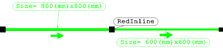

| RedInline |
2 Lines meet and continue in the same direction with different sizes |

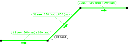

| Offset |
2 Lines meet an angle then continue in the same direction as the first line |

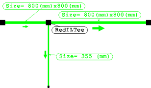

| RedILTee |
3 Lines intercept at an angle in the form of a Tee |

| Red4Way |
4 Lines meet at the same geometric point |

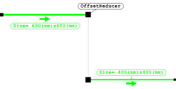

| OffsetReducer |
Line is set from the Fix By setting at takeoff leading to an Offset Reducer button code. This particular example shows a Flat left set duct transferring the full width to then become a flat right reducer. Value of movement must be entered prior to selecting new Fix By position. |
