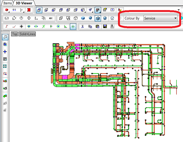

In the 3D Viewer or Fab Viewer, the Color By drop-down menu, located in the Draw Style toolbar, lets you display the model in predefined color schemes.
The following Color By display options are available:

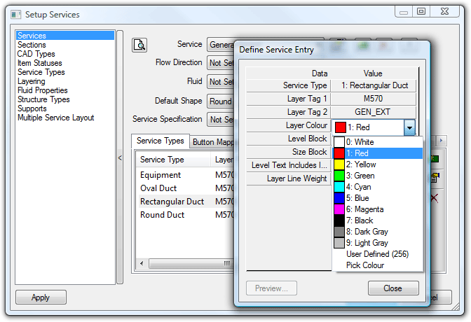

Service: When this Color By option is selected, items in the 3D Viewer\Fab Viewer display in the Layer Color specified for each Service Type in the Services Database (Setup Services Services Service Types Layer Color).

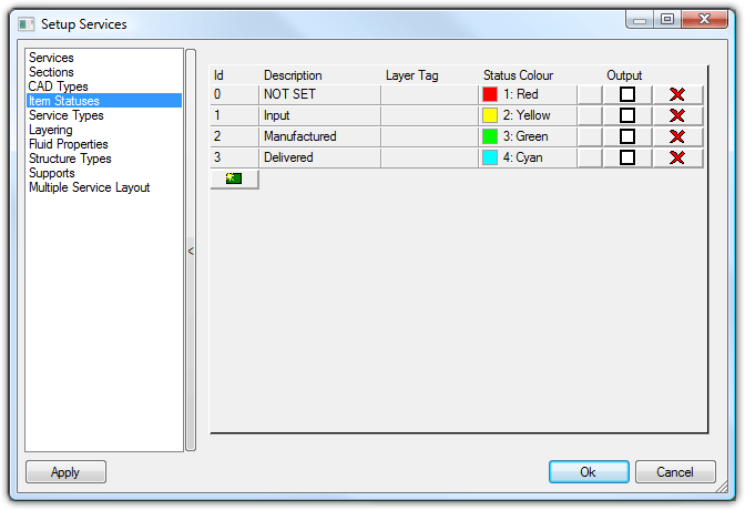

Status: When this Color By option is selected, items in the 3D Viewer\Fab Viewer display in the color specified in the Item Statuses Database.

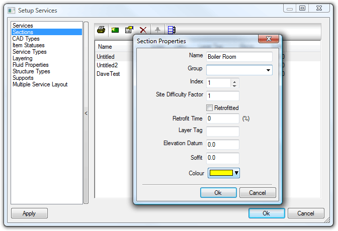

Section: When this Color By option is selected, items in the 3D Viewer\Fab Viewer display in the color specified in the Sections Database.

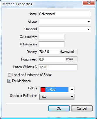

Material: When this Color By option is selected, items in the 3D Viewer\Fab Viewer display in the color specified in the Material Properties in the Material Database.

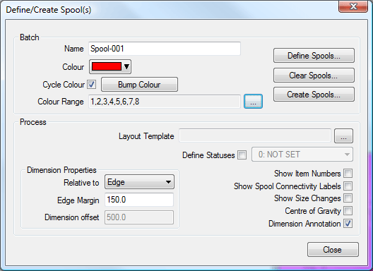

Spool: When this Color By option is selected, items in the 3D Viewer\Fab Viewer display in the color specified in the Define/Create Spool(s) Database.

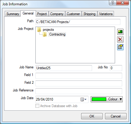

Job Color: When this Color By option is selected, items in the 3D Viewer\Fab Viewer display in the color specified in the Job Information dialog. This is normally setup at the creation of a job.
