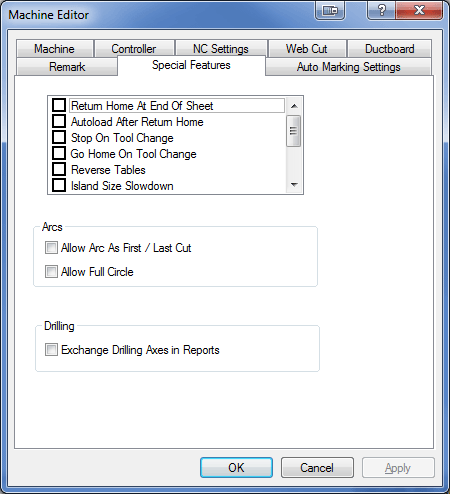

On the Machine Editor dialog, the settings on the Special Features tab determine low level machine operations that should not be changed without seeking the advice of the software vendor.
To set up or edit these settings:
Setup
Installed Machines or select the Installed Machines icon from the Utility Bar.
Depending on the machine you have, there may be several options displayed here
Allow Arc as First/Last Cut: When this option is selected, it allows the program to generate NC code which uses an Arc for the first and last cut of a part, if required, instead of having to end on a straight
Allow Full Circle: When this options is selected, it allows the program to generate a Full circle instead of many small straights.
Exchange Drilling Axes in Reports: When this option is selected, for machines that are fitted with a drill, the following print objects, related to the X and Y axes values for the drill position, are swapped in a report such as a Part Report.
This can be useful in scenarios where the machine’s origin is actually at the top left corner, rather than the bottom left corner, and there is a need to capture this detail in a Part Report. So, for example, the X axes drill position value is swapped for the Y axes drill position value, and vice versa.
