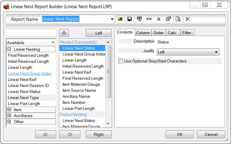

In CADmep, ESTmep and CAMduct, you can create linear nest reports using the Item Report Builder.
To create a linear nest report:
Print Layout
Linear Nest Report.
The Linear Nest Report Builder dialog displays.
A variety of item property information can be included on Linear Nest Reports, and also can be exported using the data export features. These are listed in the Available column on the right side of the Report Builder dialog. Expand the collections to see all of the properties available.
