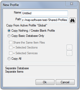

When a new profile is created by clicking , the New Profile dialog is displayed:
Copying/Amending Global to a New Profile
Creating a copy of the global profile allows the current database (services) to be mirrored to the new profile. Create a copy of the global profile when you want to keep the default global data separate, so any modifications to services, specifications a project may require can be isolated within the new profile.
  1. Enter the profile name.
  2. Select the Copy Basic Data Only and Share the Same Item Files options.
  3. Select the + Selected Sections and + Selected Services options if you want to restrict the list of services and sections for the new profile.
  4. Click OK.
  5. The Copy Basic Database and Share the Same Item Files options are made available, however, depending on the nature of the project, these options may not always be necessary. Consider the following:
    • Copy Basic Database Only: In most cases the Separate Database option is needed.
    • Share the Same Item Files: When this option is unchecked (not selected), large quantities of data are duplicated when selecting Separate Items (approx. 300Mb). This is not recommended in most scenarios.
  6. Click OK.

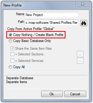

Creating a Blank Profile
Creating a blank profile allows the content to be added by importing the project data, the services, specifications etc., create a blank profile when project data has been provided in the format of: service, specification export files (*.iez, *.mst), Installation Folders\Files (usually supplied *.ZIP format).
  2. Select the Copy Nothing / Create Blank Profile.
  3. Click OK.

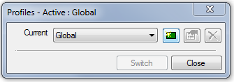

  3. Switching Profiles: When multiple profiles are available:
    • ESTmep and CAMduct: File Profiles Setup
    • CADmep: Right Click Menu: CADmep Profiles Select from directly from the list (or enter the Setup dialog)
  4. Enter the profile name.
  5. Select the desired profile from the drop-down list.
  6. Click Switch.
All drawings are saved with the current active profile. Whenever the project drawing is opened, the program checks to see if the profile is available.
