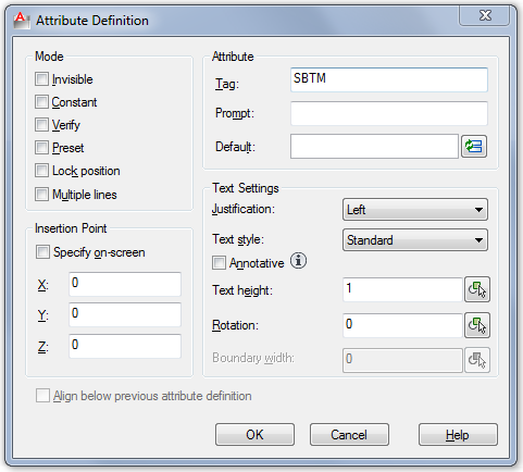

- Type ATTDEF at the command line, or click
in the CADmep toolbar.
- Type SBTM as the first Attribute Tag.
- The recommendation is to set the Text Style height to a value of 1 as this is eventually scaled by the Level - Text Style height value.
Note: If the Text Style Height field is greyed out, this indicates that the Text Style being used already has a height pre-assigned (Tools
Format
Text Style).
- Click OK to add the Attribute Definition to the drawing. (If this is not specified, it will be located at 0,0,0).

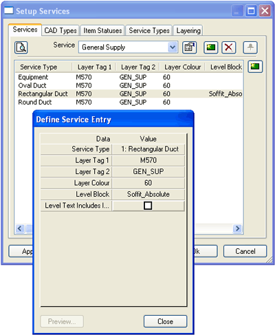

Assign the Block Definition to the Service Type
To assign the block definition to the service type:
- Select the correct Service from the Service drop-down menu; for example, HVAC - General Supply.
- Select the correct Service Type and assign the Block Definition created earlier, as shown below:
- Click Close.
- Click Apply/OK to close the Setup Services dialog.

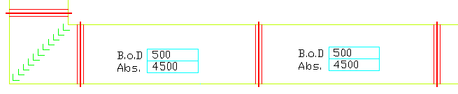

Add the Block Levels Label
To add the block levels label:
- Add a rectangular duct item to the drawing.
- Click the Levels button
- Select the rectangular duct item.

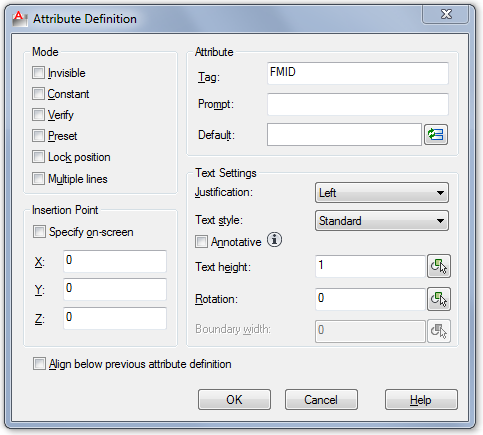

- Type ATTDEF, or click
- Type FMID as the first Attribute Tag.
- Check that the Text Style height is set to a value of 1.
- Click OK to add the Attribute Definition to the drawing. (If this is not specified, it is located at 0,0,0).

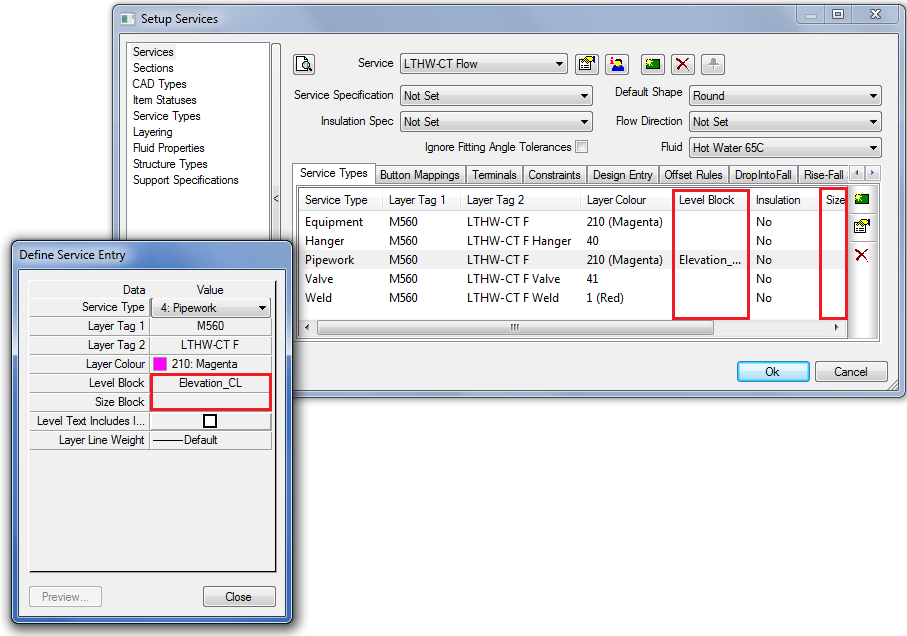

To assign the block definition service type:
- Select the correct Service from drop-down menu; for example, Water & Liquid Supplies - Mains Cold Water.
- Select the correct Service Type and assign the Block Definition created earlier, as show below:
- Click Close.
- Click Apply/OK to the Setup Services dialog.

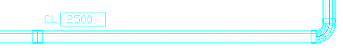

Add the Block Level Label
- Add a pipework item to the drawing.
- Click the pipework item.

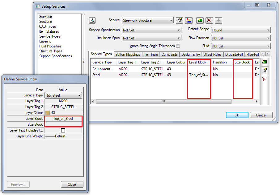

Example - Steel work -
Levels from Absolute to Top of Steel work
Create Attribute Definitions
The following steelwork example uses levels from absolute to top of the steelwork.

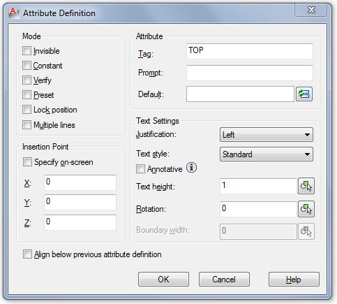

- Type TOP as the Attribute Tag.

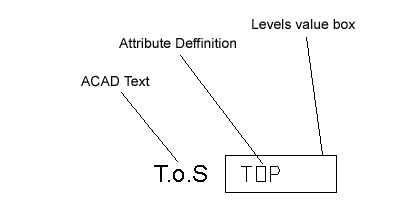

- Create ACAD Text for the Level description, as per the example below "T.o.S" - if desired create a Levels value box.
- Use the BLOCK command to create a Block Definition, and select the ACAD Text, Attribute Definition & Level value box.
- Enter a Block Definition Name e.g. "Top of Steel".
- Click OK to the Block definition dialog.
- Click OK to the Edit Attributes dialog.
Note: When setting Soffit or Elevation datum's, see
Sections.
- Select the correct Service from drop-down menu; for example, Structural - Steelwork Structural
- Click Close.
