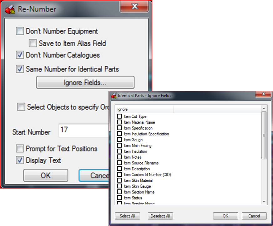

    The Renumber dialog displays. The options on this dialog are described below:
    • Don't Number Equipment: Determines whether items that have their Bought Out status set are numbered. Typically you won't renumber equipment as these are purchased items and not exported for fabrication. For information on checking the status, see the information below.
    • Save to Item Alias Field: When this option is selected, the item number is saved in the item's alias field.
    • Don't Number Catalogs: Determines whether items that have their Catalog status checked are numbered. You do not usually number catalog items as they are purchased rather than fabricated. For information on checking the status, see the information below.
    • Same Number for Identical Parts: When this option is selected, items that are identical will be numbered with the same number. When this option is not selected, parts that are identical will each have their own number. Identical items can have the same Item Number as they are interchangeable.
    • Ignore Fields: This option is used in conjunction with the "Same Number for Identical Parts" option. It lets you specify which item materials and or properties to ignore when determining if parts are identical. For more information, see the "To renumber similar items with the same number" procedure described below.
    • Select Objects to specify Order: This option lets you to pick each Item in the desired order of numbering. This is useful if the numbers are not consecutive. This option is normally not necessary.
    • Start Number: Sets the first number that is assigned. The entered value can also be a letter or combination of numbers and letters.
    • Prompt For Text Positions: When this option is selected, you are prompted to select the location on the part where the numbers will be placed.
    • Display Text: When this option is selected, the number of the item is displayed.
  3. Make choices on this dialog as appropriate for the model, and click OK.

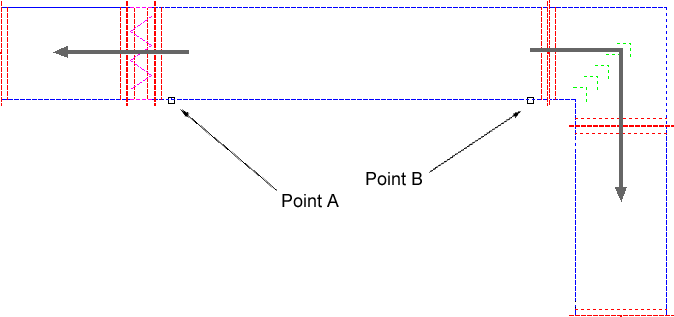

If the Select Objects to specify Order is not selected, the command line prompt should read: Select Start Duct.
  1. Before selecting the duct, there are two options: Selecting point A will result in the selection of all the following items that are connected in the direction of the end selected. Point B will result in the selection of all the following items that are connected in the direction of the end selected.
  2. Right click to apply the item numbers to the selected items.
Select Order option:
If selected, the command line prompts the following: Select Items in the Order required.
  1. Click on each item in the order that the item numbers are to be applied. It is not important which end of the item is selected.
  2. Right click to execute the command.
To renumber similar items with the same number:
  1. In the model, select the items to be renumbered.
  2. Launch the Renumber command.
  3. On the Re-Number dialog, enable the Same Number for Identical Parts option.
  4. Click the Ignore Fields button and check the item materials and or properties to ignore when determining if parts are identical.
  5. Click OK on both dialogs to renumber the items.
