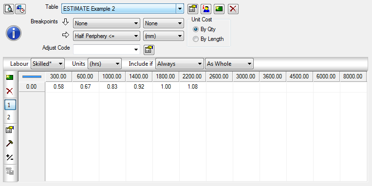

Creating additional value sets allow the user to apply separate Labor against the time. If specifying time for the same size in both Value sets, both times will be used. To work around this, we are able to enter blank entries where the two value sets overlap.

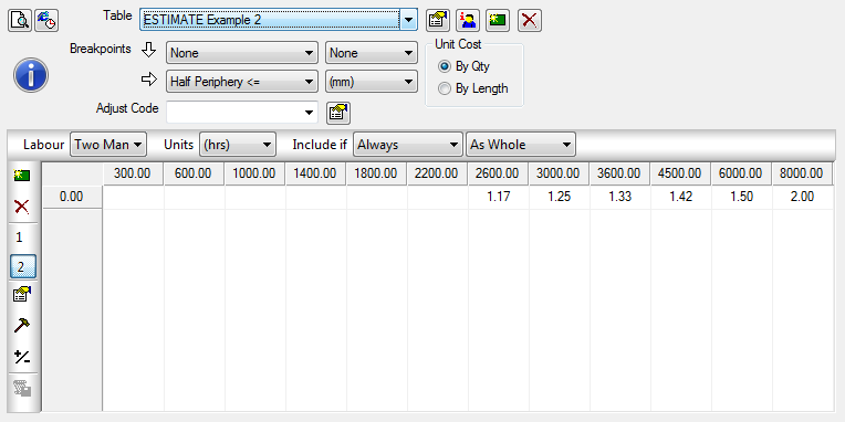

This example below shows that for Value Set 1 up to 2200 Half Periphery (Width + Depth), the Skilled Labor will be assigned to the times and the item will gain this calculation.
Using Value Set 2 above 2200, a Two Man Labor Rate will be assigned to the time, and the item when the item's size exceeds this breakpoint.

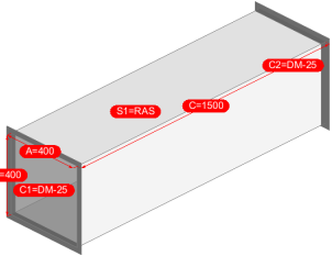

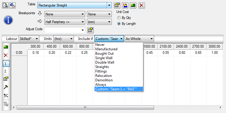

For example, this Straight is to be fabricated and has a Fabrication Time table assigned called Rectangular Straight. At takeoff, if the Seam has a value of "RAS" for its name. (S1=RAS), we can assign a specific Value set to the item. This is done by Custom Set Conditions.
Setting up two value sets and using the Include if drop-down option on each, allows selection of a condition that the item has to pass in order for it to obtain the time in the value set table.

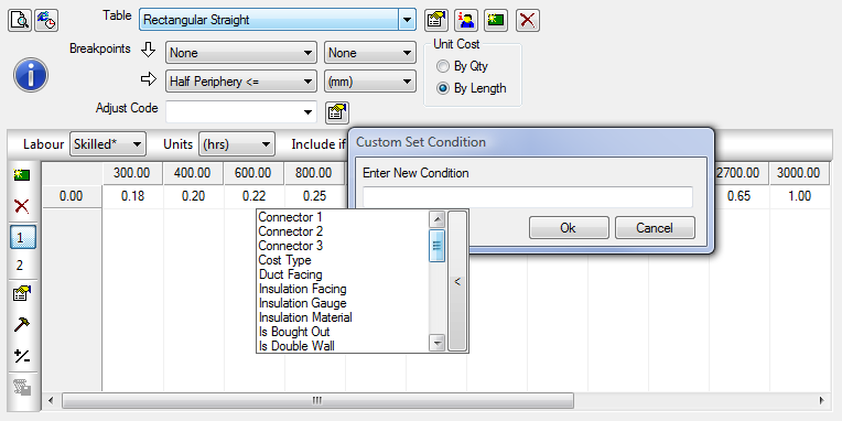

Using the Include if option allows control over whether the time is to be added to the item or not. A variety of conditions can be applied. Selecting the Include if drop-down lists all the conditions available. Selecting Custom from the drop-down list displays the Custom Set Condition dialog, shown below, which lets you create your own custom conditions. Click in the blank field on the Custom Condition Set dialog displays the list of available objects that can be used, as shown below.
Creating Custom Conditions

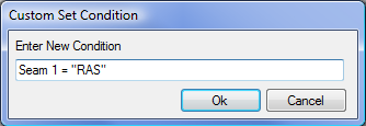

In this example shown below (Value Set 1), the Straight item has the RAS seam applied and therefore will activate condition Seam 1 = "RAS".

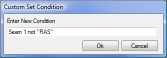

In this example shown below (Value Set 2), if the item taken off does not have the "RAS" seam name on Seam 1 value, then this activates Value Set 2.

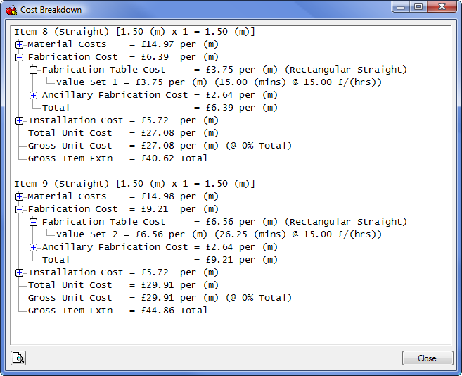

The results of the Straight Fabrication table assignment are shown below. Item number 8, Value set 1 = 15.00 mins for RAS seam application. Item number 9, Value Set 2 = 26.25 mins for non RAS seam application.
