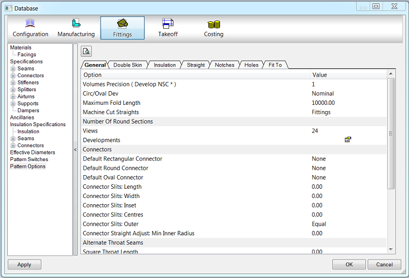

Pattern Option settings determine how a variety of items that are associated with fittings are defined in the application at takeoff. There are a variety of options within the Pattern Options settings that influence how straights, notches, holes, connectors and seams are defined within the program.
To access the Pattern Options:
- Do one of the following:
- In CADmep, right-click CADmep
Setup
Main Database, or click Edit Main Database from the CADmep toolbar.
- In ESTmep or CAMduct:, click File
Setup
Database, or click the Database icon from the Utility Bar
- On the Database dialog, click the Fittings button, and then click Pattern Options.
Pattern Options are organized into the following tabs:
- General Tab
- Double Skin Tab
- Insulation Tab
- Straight Tab
- Notches Tab
- Holes Tab
- Fit To Tab
- Standards Tab
The options available on each of these tabs are described below.
General Tab
Volume Precision (Develop NSC*): The volume of a pattern is calculated is using the Develop NSC setting, or this can be multiplied for more precision.
Circ/Oval Dev: For circular or oval part developments, this option lets you specify where on the part the diameter of the part is calculated from. The choices are inside, outside or nominal (middle). For more information, see
Circular Developments.
Maximum Fold Length: This option specifies a maximum length for a folded panel. If this length is exceeded, the pattern is split into smaller panels. This option is typically used for rectangular Straights and Bend wrappers.
Machine Cut Straights: This option controls which Specification Type is used for Cut Straights. The choices are Straights or Fittings.
Number of Round Sections
: These options specify the number of lines that the circular profiling sections are made up from. The higher this number, the more accurate circular profiles.
Views: Specifies the number of faces used to model circular and oval ducts in Takeoff views.
Developments: Specifies the number of lines the circular profiling sections are made up from. Generally, the higher this number, the more accurately circular profiles will be cut.
Connectors
: These options specify how connectors will be handled at takeoff.
Default Rectangular/Round/Oval Connector: When no specification is applied, this option lets you specify the default connector that will be used for each type of duct (rectangular, round, and oval). These are taken directly from the connectors that are set up in the database.
Connector Slits: Length/Width/Inset/Outlet: Connector slits are slits that run parallel to a rectangular connector end, and are primarily used for attaching clip-on connectors such as TDC or CGF. Specifies the length, width, inset, and outlet for connector slits at takeoff. Length sets the length of each slit. Width sets the width of the slit/slotted hole. Inset sets the distance of the slit from the end of the duct before allowances are allowed. This must be less than the allowance for the connector, or slits will not be added. Outlet sets the distance from the seam edge that the first holes is displayed , if "ears" are applied then Negative values can be entered.
Connector Straight Adjust: Min Inner Radius: Specifies the minimum inner radius for connector straights at takeoff.
Alternate Throat Seams
: On some rectangular fittings it is necessary to use a different seam for the throat than that used on the rest of the duct. The normal seam can be entered during pattern takeoff, but if the throat part of the fitting falls into the criteria set here, these settings will be used to generate its seam in takeoff.
Square Throat Length/Seam/Angle: Specifies the length, seam, and angle for square throats at takeoff.
Radius Mitred Throat Length/Seam/Angle: Specifies the length, seam, and angle for radius mitred throats at takeoff.
Remove Connector/Vee Notches: Specifies to remove connector and vee notches during takeoff.

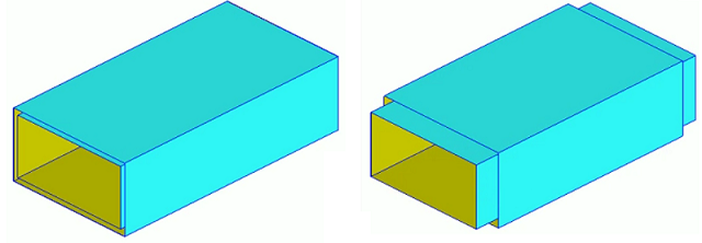

Double Skin Tab
When the Allow Double Wall Entry option is enabled in
Pattern Switches, these Double Skin options can be applied. They define the length and behavior of the 'extension' of the outside skin material, at the connector ends, for ductwork patterns that have the Double Wall option enabled. Note that these options below apply only to the outer skin, and never to the inner skin. For more information, see
Double Wall Option.
Extension
: These options allow you to specify and apply an extra material extension to the outer skin development at the connector ends. Specifying a positive value for the fitting extends (adds) an extension to the outer skin material. Specifying a negative value cuts back (reduces) this material extension of the outer skin. In the examples shown below, the straight on the left has the Double Wall option enabled on the item, and has the Double Skin Extension value set to zero. This results in the inside and outside skins being the same length, or flush with one another, as shown in the example on the left. The straight shown on the right is the same straight with the Double Skin Extension value set to a negative value of -100. Because it is a negative value, it removes or cuts back the outside skin extension, resulting in the outside skin being shorter than the inside skin, as shown in the example on the right.
Rectangular: The Extension Value to apply to the outside skin for rectangular fittings.
Round: The Extension Value to add on apply to round fittings.
Flat Oval: The Extension Value to apply to flat oval fittings.
Invert For Straights: When this option is enabled, the extension values specified here are inverted for straights.
Use For Double Wall: When this option is enabled, then the Extension settings defined here on the Double Skin tab will be used when applying Double Wall.
