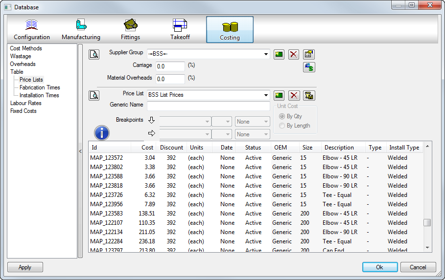

Price Lists
Price Lists can control the Bought Out price of particular items. Access the Price List parameters in ESTmep by clicking Costing Price Lists.
The default installation comes loaded with multiple Price Lists from various suppliers; for example, Lindab, BSB, Actionair, BSS, Wolseley Group, Georg Fischer, Pegler, Crane, and Hattersley, and so on. Useers can apply their own agreed discount percentages to a Price List.
Price Lists are available in two general formats: Price Lists - Product Code Based and Price Lists - Breakpoint Style.
Supplier Group: Name of the Supplier wanting to be displayed and categorized in Estimate Summary. Used to group price lists together from the same supplier ensuring the summaries/reports isolate the cost of each supplier across multiple price lists.
Carriage: Additional Net cost added to the price. (Supplier List Price - Customer Discount) - Carriage = Net Price). For example: Used for a transportation percentage from the Supplier to site if there were charges for delivery.
Material Overheads: Extra supplier based percentage mark up for inclusion into Gross cost calculations. Also accessed for each individual quotation from the Estimate Summary Overheads section.
Price List: Name of the Price list contained within the Supplier group. This is the table name assigned to the M-Rate field of each item.
Generic Name: Used for grouping price lists that contain the same product codes but from an alternative supplier. Allows Swap out of prices based on Generic name reference (Has to be entered the same across price lists) from the Estimate Summary Screen. Right click on the Supplier that is listed in the Summary > Change Supplier.
