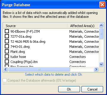

    The Purge Database dialog is displayed.
    This dialog displays all the entries in the default database (disk database) that have been added via an external sources.
  3. Select all the entries to be purged / deleted and click OK.
