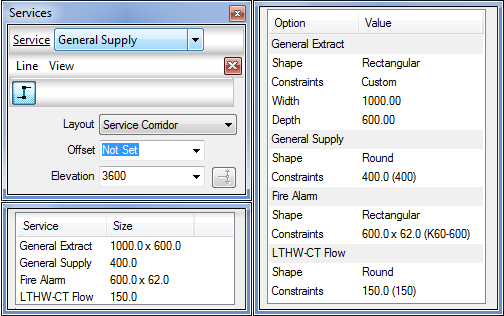

- The Services pallet dialogs displays. Configure the multi-service line by specifying the following options in this dialog:
- In the menu bar located near the top of the Services pallet dialog, click Line

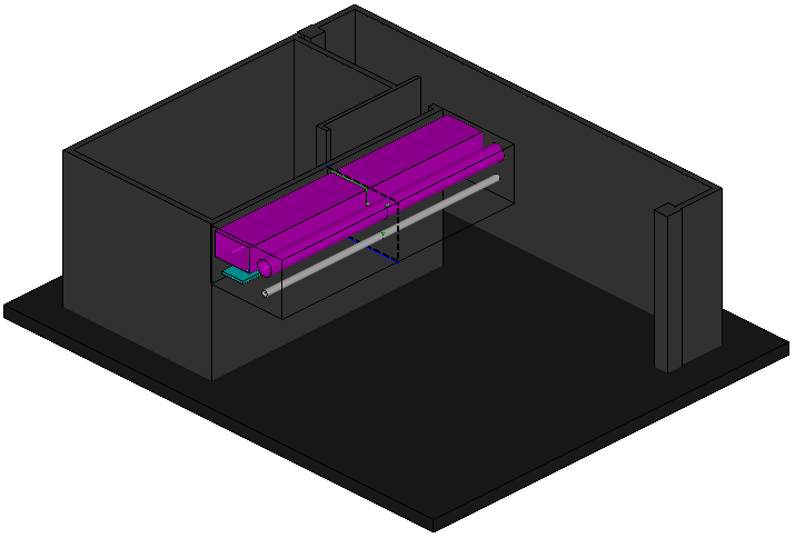

- In the model, click to select the appropriate start and end locations, and right-click to end the command.
As illustrated below, the multi-service line is now ready to fill in 3D which will populate the services.

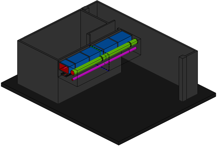

- In the menu bar located near the top of the Services pallet dialog, click View
Fill. The items for each individual service will be applied, as shown below.
