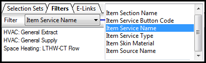

  1. Select within the Workspace toolbar Filters.
  2. From the drop-down menu, select Item Service name, the dialog will populate all the active services contained within the model. By default the Filter is set to None.
  3. To select all the items that are contained within a connected service system, right-click on the appropriate service name. For example, HVAC : General Supply.

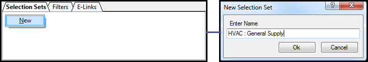

  5. Click the Selection Set tab, then right-click within the Workspace pane, as shown below, and click New.
  6. At the New Selection Set dialog, specify a name for the Selection Set, for example, HVAC: General Supply, and click OK.

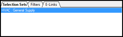

    The selection set for the HVAC: General Supply service is populated in the dialog. This Selection Set can now be utilised on various commands within the Autodesk Fabrication products.

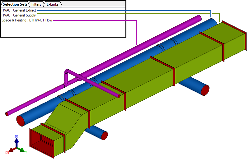

  7. To populate other services within a model, repeat the same procedure.
