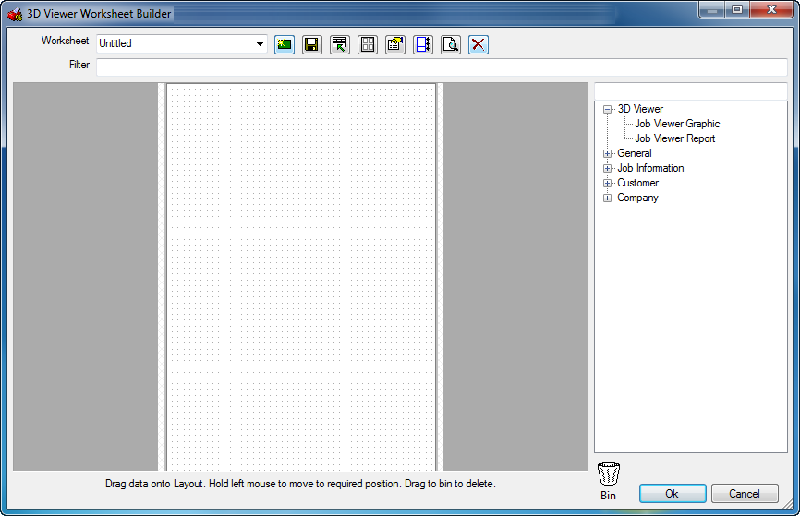

  2. The Worksheet Builder dialog is displayed .
  3. Select the "New Worksheet" icon.

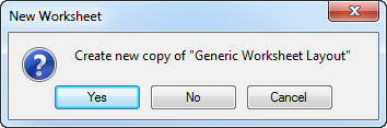

  4. A "New Worksheet" dialog opens - "Advising the user if they want to create a copy of an existing. Select NO. A blank worksheet will now be created. Alternatively if YES is selected a copy of the active worksheet in the dialog will be duplicated.
  5. "New" blank default paper Work Sheet.
  6. Rename the Default "New" blank worksheet, by selecting the adjacent bar next to the Title "Worksheet". Name as required.
