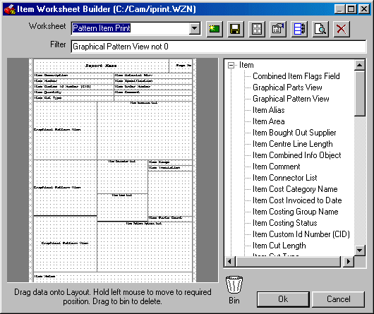

The Item Worksheet Builder dialog displays.
Creating the layout of the worksheet using the Worksheet Builder is using the Label Builder. Features that are exclusive to the Worksheet Builder are described below.
Worksheet: Select an existing worksheet from the drop-down list.
Create New Worksheet: Creates a new worksheet. You can create a new blank worksheet, or create a copy of the current worksheet.
Rename: Displays the Save Layout File dialog which lets you specify a new filename and or location for the current worksheet.
Header Layout: Lets you drag selected data onto the Worksheet. This can be used to create labels from worksheets if the information required on the labels is only available in the Worksheet Builder.
Properties: Displays the Worksheet Properties dialog which lets you set the following Output options:

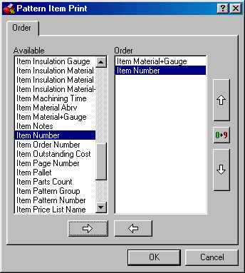

Define Print Order: Displays the Pattern Item Print dialog. Items can be added to the right hand column from all of the possibilities in the left hand column by highlighting the desired Print Object and clicking the arrow button
. Remove objects using the left button,
and moved up and down, changing their order of appearance in the report.
Reverse Order: This button on the Pattern Item Print dialog reverses the order of the items displayed in the Order pane.
Print Preview: Displays the selected worksheet based on the currently open job.
Delete: Deletes the worksheet layout.

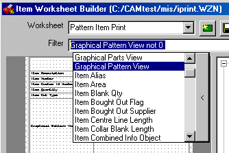

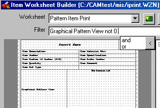

Filter: A filter for the report can be constructed by clicking in the entry field, and then clicking the required entry from the drop-down list, or entering a value using the keyboard.
