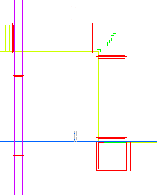

    For example, below is a sample original view , before a sectional view has been created.

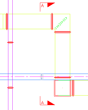

  2. In this example, select Section View A-A and then click to create the sectional view.
