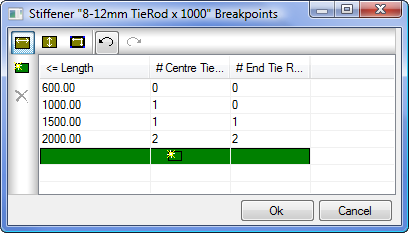

The length breakpoint table specifies the quantity of rods along the width and/or depth of duct, based on the length of that dimension. A quantity can be allocated on each position: Centrally and Externally. Only if the stiffener has been set to Internal or Both for Central or End types would tie rods quantities be used based on this dialog. Application of 1 central and 1 end would result in at least 3 tie rods as there would be at least 1 in the middle, and at least 1 at each end of the duct.

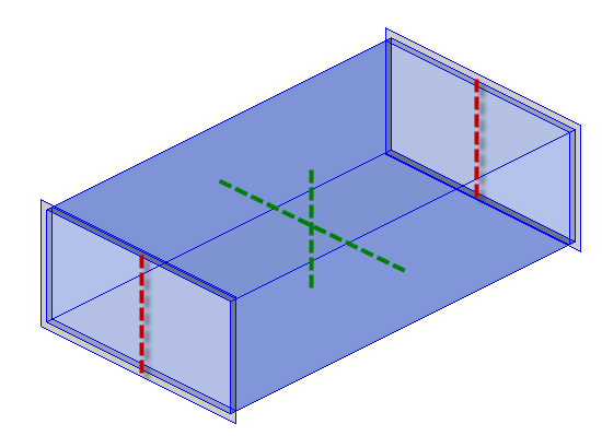

For example, a 1500x750 duct will obtain for the 1500 side, 1 central and 1 at each end. The 750 dimension obtains just the 1 central as specified in the above table. In the illustration below, red indicates End Type tie rods, and green are Central Type rods.

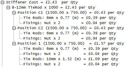

Evidence of this configuration can be seen by displaying a Cost Breakdown on the item, as shown below.
Position C1 relates to Connector 1 end. Position C2 is for Connector 2, and Position 1 is, in this example, the Central Tie Rods. Position 1 in this example showing 0.77m for the 750mm side, plus the 20 mm extension for the nut, and then 1.52m across the long side. with allowance for 20mm extension for the nut.

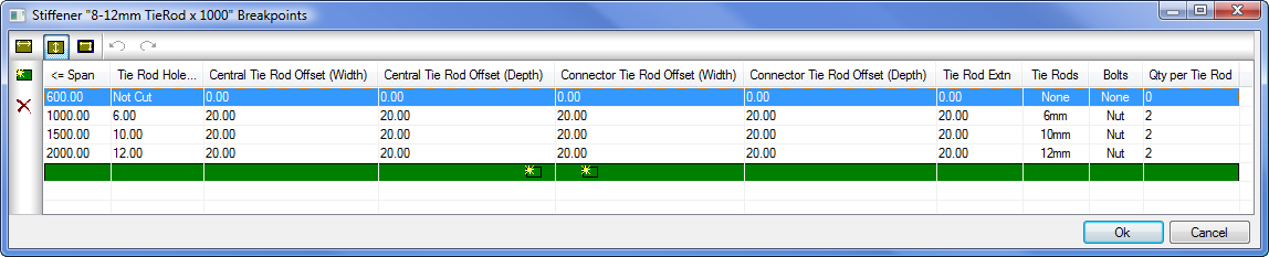

The span breakpoints only apply when using internal stiffening (Tie rods). The span of the tie rod (its length) determines the type (diameter) of it. The length used is the opposite duct side length than the side that was used to determine the number of tie rods in the 'Length' breakpoint table and it defines the rod and bolt types + hole diameter to cut for each tie rod. Although the number of tie rods is determined off the width, the type of tie rod is determined by the depth, and vice-versa.
As shown in the example cost breakdown above, span breakpoints can be specified to allow for variant rod thicknesses and values to offset 2 rods when using vertical and horizontal rod placement. Based on the size, we can dictate the Hole diameter to be cut on the development for manufacture, and where to offset the holes from the edge of the duct.
In the example below, there will be a 20mm inset on all holes.
The ancillary assignment for the Rods can be allocated using the Tie Rods drop-down and refers to the Ancillary list for Tie Rods that can be created and linked to a price list per meter. Bolts can be assigned specifying the quantity per tie rod as shown in the Cost Breakdown dialog earlier. Notice the 1500 side used a 10mm Rod and the 750mm side uses a 6mm rod.
