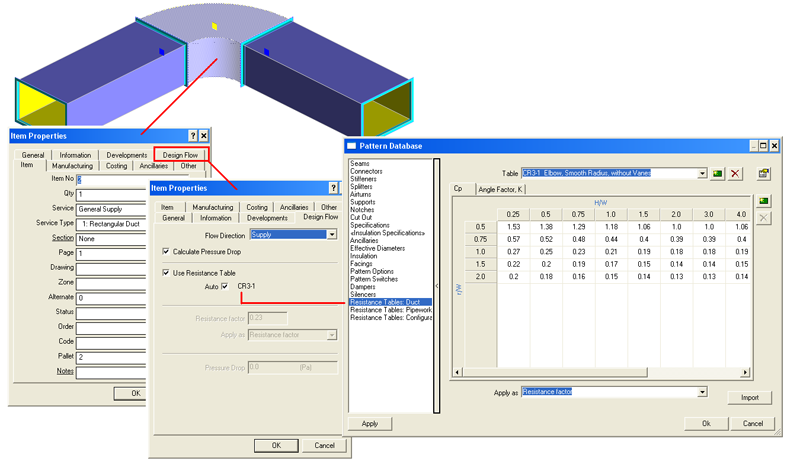

Ducting

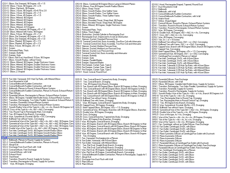

Historically, the Fabrication product software has been linked to ASHRAE tables that determine the additional resistance (K value) to flow introduced by standard rectangular and round fittings. Many of the existing duct fittings are linked to the appropriate table information through hard coded conditions. For example, a Rectangular Radius Elbow is dynamically linked to table CR3-3 if splitters are used, and to table CR3-1 if splitters are not used.
Some fittings require more than one worksheet to calculate the resistance. For example, CR3.1 has a sheet (Cp) that relates resistance to the duct Width/Depth v Width/Throat Radius. The larger the radius, the less the resistance. A second sheet (Angle Factor, K) adds a correction introduced by the Elbow Angle: 30, 45 or 90 degrees.
The ASHRAE table names identify the type of fitting to which the tables are applicable:
Each sheet relates specific fitting dimensions, and in some cases flow rates, to resistance values.
Historically, the Fabrication software linked common rectangular and round fittings to the ASHRAE tables. These are identified from the fitting's Design Flow tab on the Item Properties dialog. If Auto is selected, this enables the built in automatic conditions linked to the ASHRAE tables.

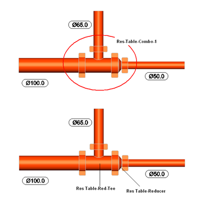

The set up allows for Resistance Tables that can be assigned to a combination of fittings or to treat the fittings individually.
When using Design Line as the basis of pressure drop calculations, the Button Mapping can be configured to treat a NODE as a combination of fittings and to assign the correct Resistance Table.

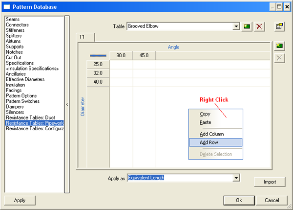

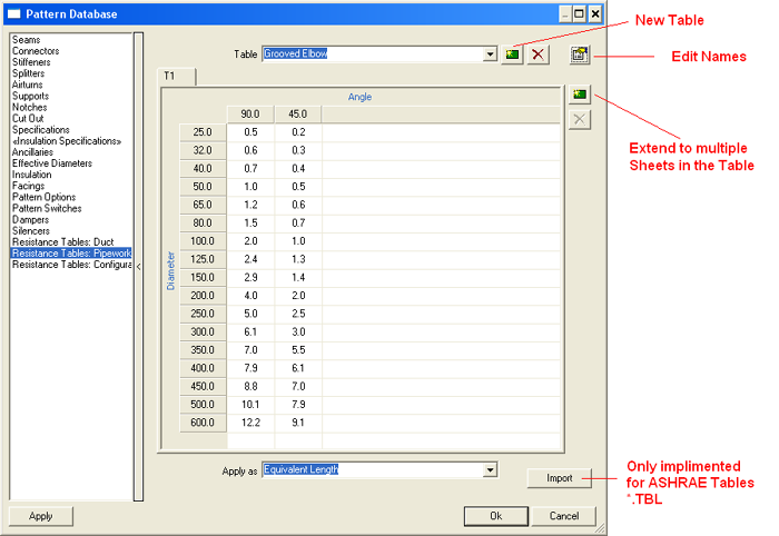

The following example describes how to configure a new Resistance Table to be used on a Grinnell Grooved Elbow using "Equivalent Lengths".
  1. From the Pattern Database, choose Resistance Tables: Pipework.
  2. Select New and enter the Table, Column, Row and Header names for the 1st Sheet.
  3. In the "Apply as" field, select Equivalent Length.
  4. Right click in the table to add columns and rows as required.
  5. Select columns and rows with Arrow Tool to delete or add a column. Press the Shift key on your keyboard to select multiple rows/columns.
  6. Add the required angles and equivalent lengths.
For this example, the data was taken from Grinnell's metric data sheets.
Note: All the Resistance Table data is stored in the "Database" folder in following 2 files: Resistance.map Resistlink.map

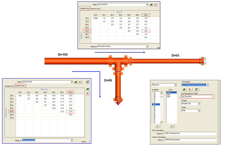

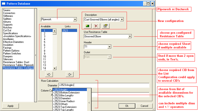

Linking Resistance Tables to Fittings
To associate Resistance Tables to fittings:
  1. From the Pattern Database choose Resistance Tables: Configure
  2. Select Pipework rather than Ductwork from the top center drop-down.
  3. Start a New configuration and enter its description.
  4. Choose the Resistance Table previously defined from the List: Grooved Elbow
  5. The Header (Sheet) defaults to the first and only one in this table.
    Available & Links Columns: The targeted Resistance Table needs to be linked to the Fitting Templates it refers to. Fittings are referenced by their CID No. In many cases, a single fitting is linked to a Table. Multiple fittings are also supported.
  6. Locate the CID No required from the Available List and move it across to the Links column.
  7. Add other CID No's if required.
    Row & Column Calculations: The names assigned to the rows and columns in the Active Resistance Table will be displayed. In the example above, these are Diameter & Angle. After the CID's have been assigned, the Dimensions associated with CID's are available to pick in the data entry boxes.
  8. Click in the box and pick the required dimension. The CID No. precedes each dimension. The entry can be made into a calculation by adding the +-*/ operators.
  9. Press the Space bar to toggle between the dimensions and the Operators.
    Brackets will sometimes be required to separate calculations. The exact syntax is important and a common error is in not having this correct.
    If 2 CID's are active, the CID No differentiates the dimensions, as follows:
    <4:Inner Radius> + <4:Top Width> /2 (<4:Inner Radius> + <4:Top Width>) /2
    In the examples above, 4 is the CID No.

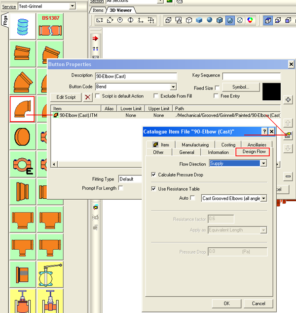

Assigning a Resistance Table Configuration to a Single Fitting
To assign a Resistance Table Configuration to a single fitting:
  1. Right click on the Button associated with the required Fitting. Highlight the entry and click properties.
  2. Select the Design Flow tab.
    Flow Direction: The Service should reflect if it is configured for Flow or Return. Some fittings have different resistance characteristics when used for flow or return.
  3. Calculate Pressure Drop should be selected.
  4. Alternatively, de-select and add a fixed known pressure drop.
  5. Use Resistance Table should be selected, and a table assigned. Alternatively, de-select and add a fixed known Resistance value.
    The Auto Box is only selected for duct items that have pre-determined hard-wired rules associated with the ASHRAE Tables.
Note: This is the simple way to use Resistance Tables to calculate pressure drops.

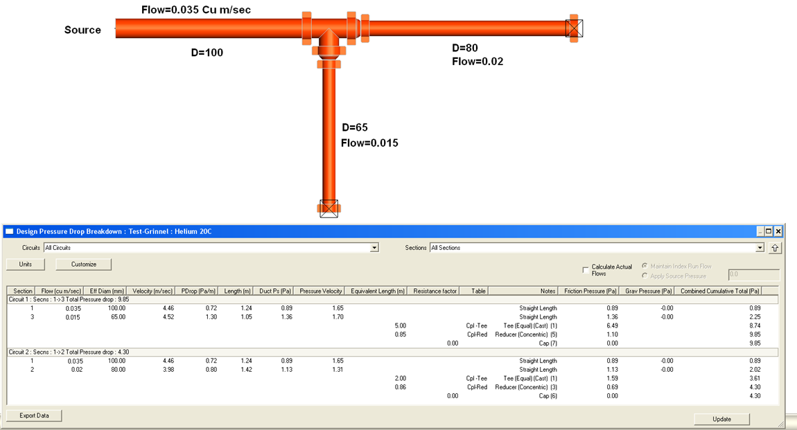

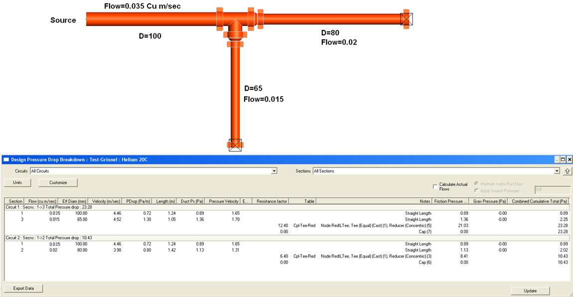

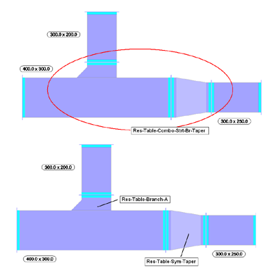

The Design Line feature is however more complex, and if a Filled Node contains more than one fitting, the software examines the available Configurations (Rules) to find one that matches the fitting combination.

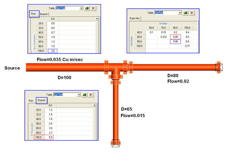

Example: Combo Tee and Reducers in Each Leg
Assume a table is available that represents the resistance factor when a Tee is close coupled with reducers at both ends.
The Rules (bottom right) link this Table (Cpl-Tee-Red) to the In and Out dimensions for the main and Branch runs of the combo.
If the Design Line introduces a Node that includes the fittings (CID=2044, 2051, 2051) it applies the rule.
If it cannot find a Rule to match the combo, it drops through to individual Resistance/Equivalent Length Tables.

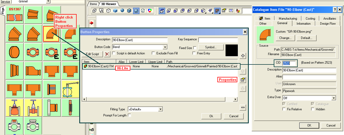

Determine the CID No of any Item in a Service
It is necessary to know the fitting CID numbers that a particular Resistance Table will be linked to. For example, the Grinnell grooved Elbow is based on CID =2523.
To determine the CID No for an item in a Service:
  1. Right click on the Button (item) in the Service Pallet, and click Button Properties.
  2. In the Button Properties dialog, highlight the required item, and then click on the Properties button.
    The CID No is displayed in the Pattern Template (General) tab, as shown below.
Note: CID=2523 is the template used for modelling most piping Elbow items. A reference to 2523 is needed here in order to extract the dimensions applicable to this model.
