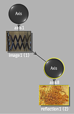

  1. In the schematic, select the surface, 3D model, or 3D text to which you want to apply the diffuse map.
  2. Click Media.
  3. In the Media menu, select the media you want to use for the diffuse map.
  4. Do one of the following:
    • Drag the Reflection Map node from the node bin and place it in the schematic.
    • Drag the Reflection Map node from the node bin and place it where you want it in Result view.
    • Double-click the Reflection Map node. You do not need to be in Schematic view to add a node in this manner.
    The reflection object is added to the schematic with its own parent axis. The new axis is the child of the selected surface or geometry. In Schematic view, the number in brackets next to the name of the Reflection node indicates the media used for the diffuse.
    To specify different media as the reflection source, select the media in the Media menu, then click Apply.
