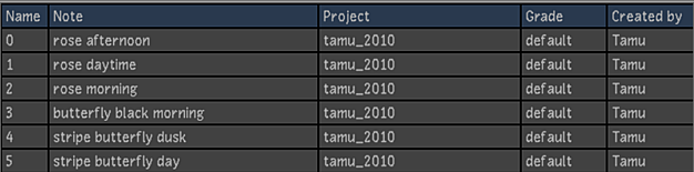

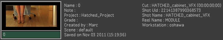

When you view grade files in the expanded Grade bin, you can display information about the media files.
Details view
Footage courtesy of EVN PRODUCTIONSList view
Note: Text information is not displayed in Thumbnail view.
- Name
- Displays the name of the grade file.
- Note
- Displays any notes saved with the grade. Right-click to edit the note.
- Project
- Indicates the project in which the grade was created.
- Grade
- Indicates the original grade in which the grade file was created.
- Created by
- Indicates the user that created the grade.
- Scene
- Indicates the original scene in which the grade was created.
- Saved on
- Displays the date on which the grade was saved.
- Cut
- Indicates the original cut in which the grade was created.
- Shot UId
- Displays the shot’s unique ID.
- Shot Name
- Displays the name of the shot saved with the grade.
- Reel Name
- Displays the name of the source reel on which the shot is saved.
- Workstation
- Displays the workstation on which the grade was created.
To sort List view information:
- Do one of the following:
- Click a column header to sort the list in ascending order by selected column. Re-click the column to sort the list in descending order.
- Press Ctrl and click any column header to reset the sort order by name.
