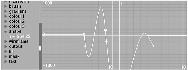

The Shape channel is used to identify the number and location of shape keyframes in a clip. Use the shape curve to control the rate at which an object changes to a new shape. The following figure shows the Shape channel for an object that changes from shape 1 in frame 1, to shape 2 in frame 8, and shape 1 in frame 15.
