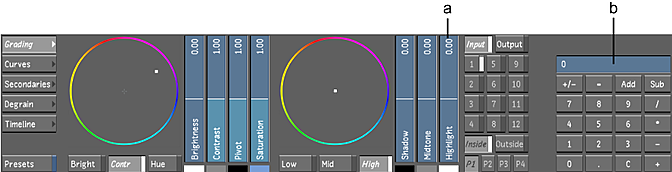

(a) Active slider  (b) Calculator  

The calculator features a numeric keypad and buttons for performing standard operations such as addition, subtraction, multiplication, and division. To enter numbers, you can click the calculator buttons, or press the keyboard's number keys or numeric keypad.
It is also possible to assign a negative value to a slider with the calculator.
