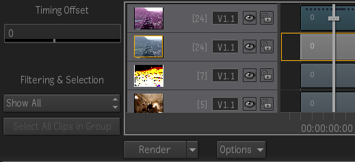

Using the Timing View to Offset Clips
When you offset a clip, you simultaneously offset all its segments on each track. You can also offset multiple clips simultaneously, including all clips in a group.
To offset clips:
  1. To access the Batch FX Timing view, click the Timing button.
  2. Select the clips and/or segments to offset. If you are offsetting all clips in a group, select one clip or segment in the group and then click Select All Clips in Group. To select all clips on a track, click the clip proxy to the left of the track.
  3. Drag left or right in the Offset field, or enter the number of frames by which to offset the clip.
    All selections are offset by the same amount.
    Note: If you offset multiple clips simultaneously, the value in the Offset field resets to 0 when the offset is complete.
