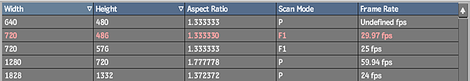

The parameters listed in the Default Resolutions menu act as default values for all listed resolutions. For example, if you want to change the default values for PAL clips, you must change the values for the PAL entry, which is the entry that has a width value of 720 and a height value of 576. If you are working with a PAL archive created in an earlier version, the aspect ratio would have automatically been set to 1.3333, but you may want to restore all your PAL archives with 16:9 aspect ratio. You can change this setting by changing the aspect ratio to 16:9 for the PAL entry.

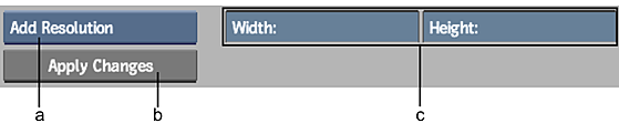

To add a default resolution:
  1. In the MediaHub, browse for Archives and click Default Resolutions.
    The Default Resolutions list and menu are displayed.
    (a) Add Resolution box  (b) Apply Changes button  (c) Width and Height fields  
    (d) Aspect Ratio field  (e) Aspect Ratio box  (f) Scan Mode box  (g) Frame rate box  
  2. Add new preferences to correspond to a specific clip resolution contained in the archive that you plan to open.
  3. Click Add Resolution.
  4. Click Apply Changes.
    The new archive preference is added to the list. The next time you restore an archive missing either Scan mode or aspect ratio, Flame Assist knows how to process that material.
