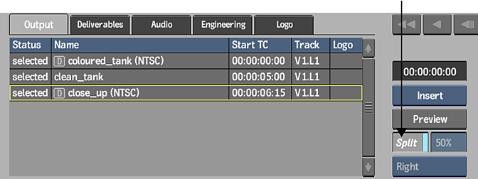

When you output a clip to a tape that already has media on it, you can enable a split view to compare a clip with a portion of tape, in much the same way as split view allows to compare two video segments in the player. This can be especially useful if you are outputting a clip to seamlessly overwrite a section on the tape.
To use the split view preview option:
  1. In the Output tab of the VTR Output module, enable Split.
    The Split View controls are enabled and you can view the clip that is currently set for output alongside the content on the tape.
