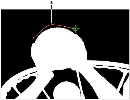

  4. Do any of the following to draw the garbage mask:
    • Click to add vertices.
    (a) Vertex added by first click  (b) Vertex added by third click  

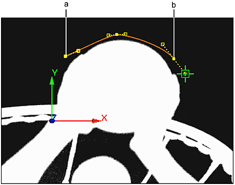

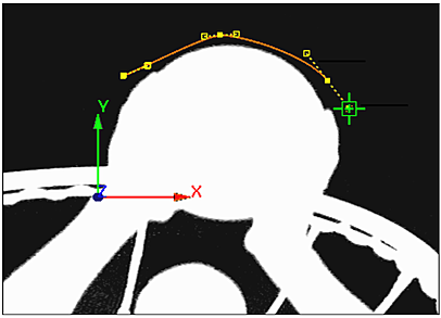

    • Click-drag to control the tangency of any vertex as you are drawing the mask. When you release, you can continue to add vertices.
    Tangency handles extend as you drag from a vertex

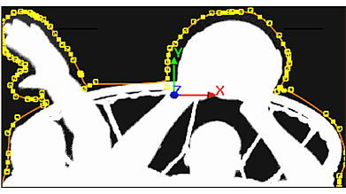

    • Shift-drag to add freehand segments to the mask. The vertices and tangents of the mask you are drawing are temporarily hidden. Vertices are added where you drag, and appear when you release Shift. After closing the mask, you can use the Lasso Fit parameter to increase or decrease the number of vertices that define the freehand segments of the mask. See Adjusting the Number of Points in Freehand Segments.
    Segments of garbage mask drawn freehand

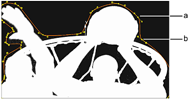

    When the garbage mask is closed, its vertices and tangents can be edited and animated.
    (a) Vertex  (b) Tangent  
